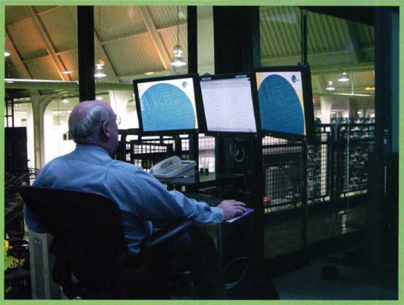

Stan Kolish, regional manager of Alion Science and Technology, at one of the C3 workstations.

All part requests are tracked,and if needed be, assisted by a stateside Communications and Control Center in Detroit. The so-called C3 Unit, housed in a futuristic looking two-story module with sliding glass doors, is found inside a former Ford Mortor Company engine plant. Once again a bustling manufacturing center, the facility is owned and run by a local non-profit called Focus: HOPE, which trains the city’s jobless to be machinists while fulfilling orders for the big-three automakers and others. On a recent day, stacked near the C3 module, and not far from a Mazak Integrex 300-IISY and a Vibe Tech de-burring machine, a run of finished engine parts for the 2006 model Cadillac awaited pickup.
Entering the C3 through an ultramodern, dual-sliding glass door is a bit like walking onto a Star Trek set. A pair of workstations worthy of the S.S Enterprise each offer a trio of eye-level flat-screen monitors. Nearby stands the server that links these workstations with its counterpart the MPH, either via a T-1 line, as has been the case so far, or via satellite. If eye contact is necessary, staff can make the connection visual. So far, the MPH is staffed with contractors on rotation from the United States.
“The Army’s trying to decide: ‘Do we want to field it with contractors or soldiers?’” says Kolish, sitting at one of the workstations.” We’re trying to program it so soldiers can operate it. If the part (to be built) is in the database, it’s pretty easy. You call it up, go to the tool list and bring up a picture of the tool so you can see you’ve got the right one, it tells you to hit this button; you hit that button.”
If the desired part is not found in the MPH database of ready-to-run jobs, the C3 steps in. With the engineering support from another subcontracting partner. Cleveland, OH-based CAMP, Inc., the C3 gathers the necessary CNC machine code and 3-D models, and in many cases, will transmit the necessary information bact to the MPH. However, the MPH will not always have the proper raw materials or perhaps the capability to make the part. In such instances, the plan calls for the job to be run by a so-called agile manufacturing cell back in the United States. The shop floor surrounding the C3 here at Focus: HOPE is one such agile cell. Others, each specializing in particular parts, would theoretically be located at various Army sites.
