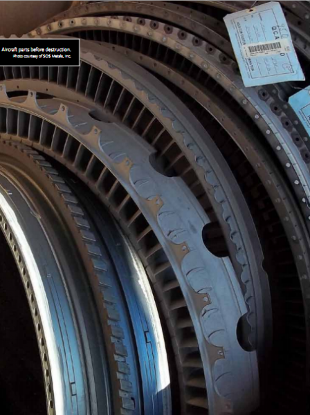

Aircraft parts before destruction.

Some recycling companies, such as SOS Metals, Inc., headquartered in Gardena, Cal., offer formal procedures for making parts, assemblies, and equipment permanently unusable. Termed in the industry as certified destruction, this process takes care of the scrap, obsolete parts, etc. that need to be kept out of the supply chain. A similar process handles military equipment that needs to be made unusable. SOS Metals has contracts with many airlines and aircraft original equipment manufacturers (OEMs) to perform the certified destruction of parts and assemblies, as well as the necessary approvals for handling destruction of military items, said Andrew Ballow, the company’s vice president of business development.
Because a certified destruction company has been qualified by its customers (airlines and OEM manufacturers, for example), procedures are in place to make parts traceable and, Ballow said, “if anything should happen, the liability would be on us.”

“Our processes depend on the parts,” Ballow said. “We would use a plasma cutter on some of the bigger parts. We’d use a chop saw—it’s kind of like a radial arm saw, you just pull it down and chop the part in half. We also use alligator shears—shears that have a mouth like an alligator. Instead of teeth, it’s got blades. You put a part on there, you press the switch with your foot and cut the part in half.”
“For smaller parts—if someone ships us a bunch of aircraft hardware, or we dismantle an engine—we have nuts, bolts, screws, rivets that have to be destroyed,” Ballow said. “If you did it piece by piece, it would take forever, so we have something called a hammer mill.
“A hammer mill has a conveyor that picks up the material and drops it into the top of the mill. Inside there is grinding media, like steel teeth, that does damage to anything you put in there. It will crack it or mutilate it. It will crack the head off a bolt. A thread? You can’t use that thread anymore.
“We dump [the parts] into the hammer mill. It grinds, and chunks, and bends, and breaks, and destroys the threads and heads, so the parts cannot be used or sold as new.”
